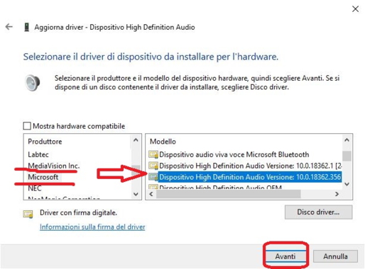

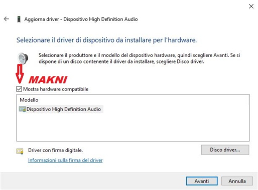

driftingstag84 driftingstag84 Member
What a mess you've got there.
Try this approach (unfortunately my PC is set to Italian), but just look at the images—it isn't difficult.
Search for it in the Device Manager and try this driver first. If that fails, test the others; one of them has to work.
Best,

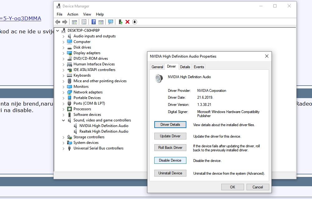

And you should probably remember to disable the audio on your graphics card.
By the way, is this some specific branded machine, like maybe a Compaq or an HP?
You should really take a peek at this video too!
And just a little heads-up, you might want to double-check where you're plugging in that speaker; I'm thinking the ac97 port probably shouldn't go into the light green jack, though I guess it might be configured a bit differently than that.

Just head over to the Device Manager, right-click on the item, go into Properties, hit the Driver tab, and then select Disable device.
