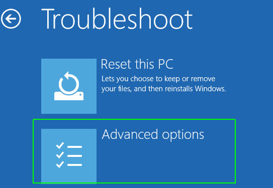

Shut the machine down completely. Once you power it back up, hold down the F11 key; you should be greeted by a menu looking something like this:
Select the troubleshoot option,
then move into advanced options,
and finally, click on startup repair.
One thing, though—before you start tinkering with anything, unplug all the peripheral clutter from the tower, like external hard drives or USB sticks. It’s better to have a clean slate.
If you're working on a laptop, it's even wiser to strip it down entirely; pull the battery out for about ten minutes before you begin the process.

Morgan Rodriguez40 said:Give this a shot,
Thank you, I will try that.
